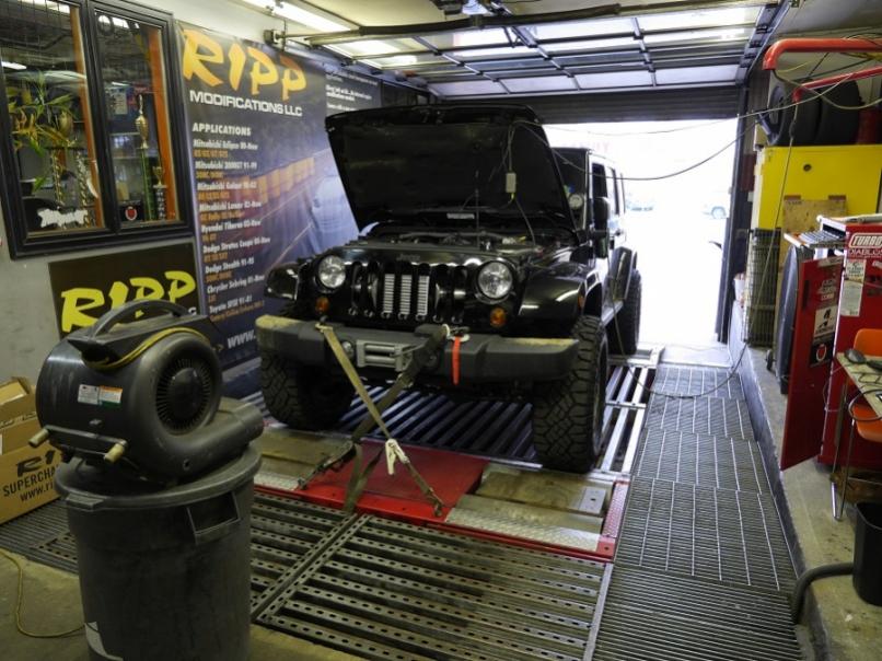

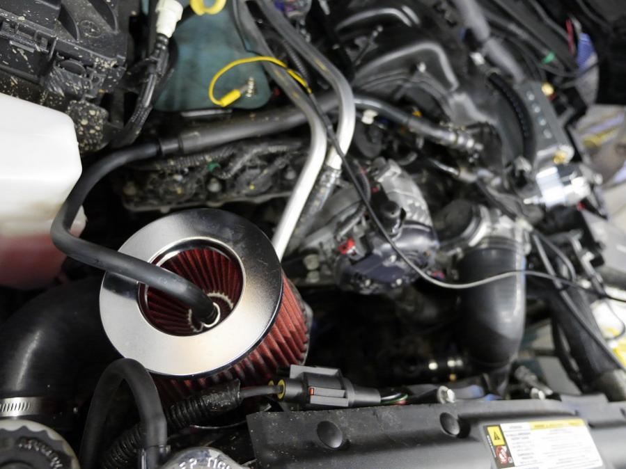

    Drove it for the first time today. It is very fast. The boys at ripp installed it, so im going to get more involved explaining the installation later. Suffices to say, the install was done in one day, then the dyno passes began. I'll post the before and after dyno numbers as soon as I dig up the pictures.
    Here is the short version so far. Ross from RIPP is pulling my truck off the dyno for a test drive, motions to me to get in. I'm freaking out with delight, as I had tried to stay out of his way for the last hour while he was dialing it in on the dyno. I jump into the passenger seat, ready to fire 1000 questions.
    The first question that comes out regarding the prototype supercharger set up. "So do I have to be careful with this thing?" I asked. Ross looks at me with a smirk, and then turns down a deserted alley, "watch this" then floors it. I can hear the WHHIIIIIIIIRRRRRRRRRRRR of the SuperCharger spinning. I was knocked back into my seat. He chirped the tires, with a hard shift into second, then to my amazement, CHIRPED THEM AGAIN going into 3rd!
    He was showing me that the "Prototype" that I had was not delicate or fragile. He explained that the dyno runs he had been doing for the last 2 days were harder on the system than anything I was going to do to it on the road.
    I drove it home on the NJ turnpike where I could open it up, but didnt get too aggressive with it. Ill give you guys my thoughts after I drive it cold tomorrow.
    Overall im impressed so far. but ive only driven it a short distance and really haven't gotten on it.....Yet.
