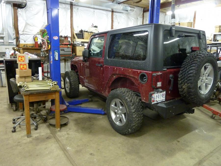

    Here is Jesse's girl pulling into the bay preparing to lose some parts!

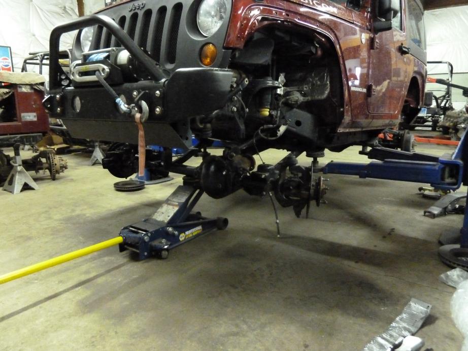

    Wheels off, and stock axle coming down!
