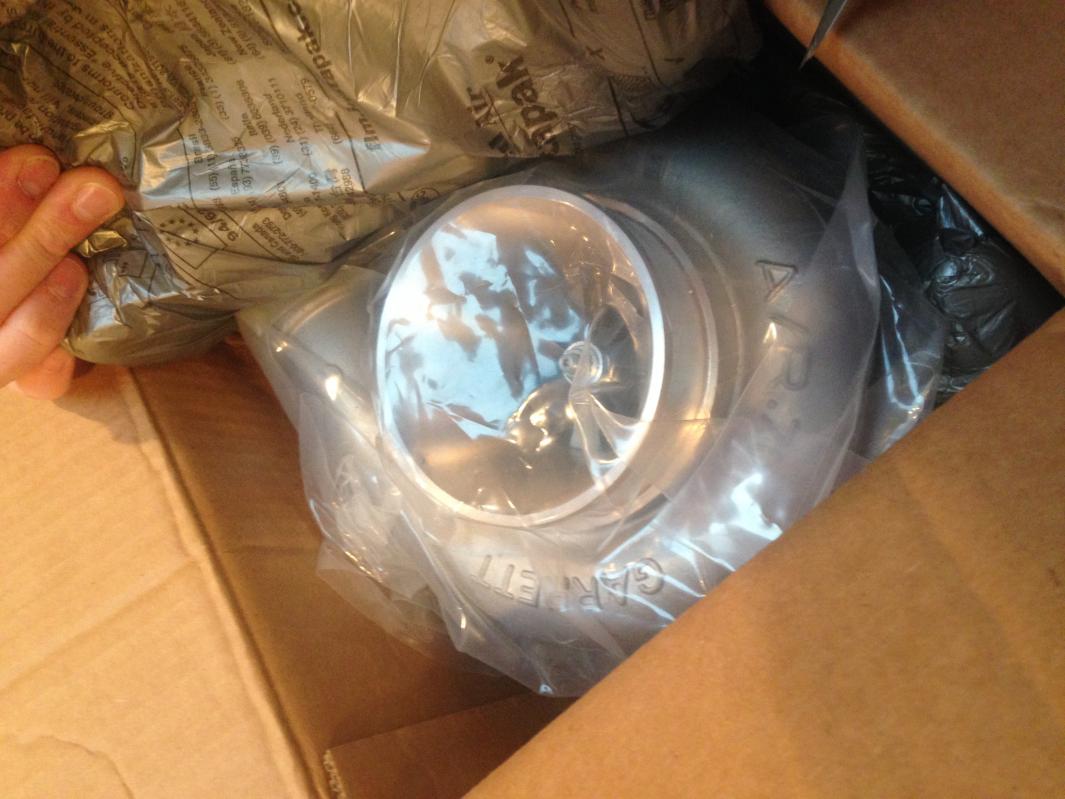

    Here's a shot of Jessee as he opened the Turbo.
