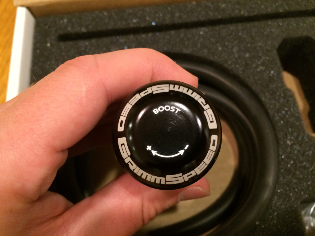

It's actually on the expensive end for manual boost controllers, but I like the precision and resolution of its adjustments (distinct "clicks", each adds about 0.25 psi). At the other end of the spectrum is cheap ebay boost controllers that look like they were put together from basic plumbing/pipe parts from a hardware store.

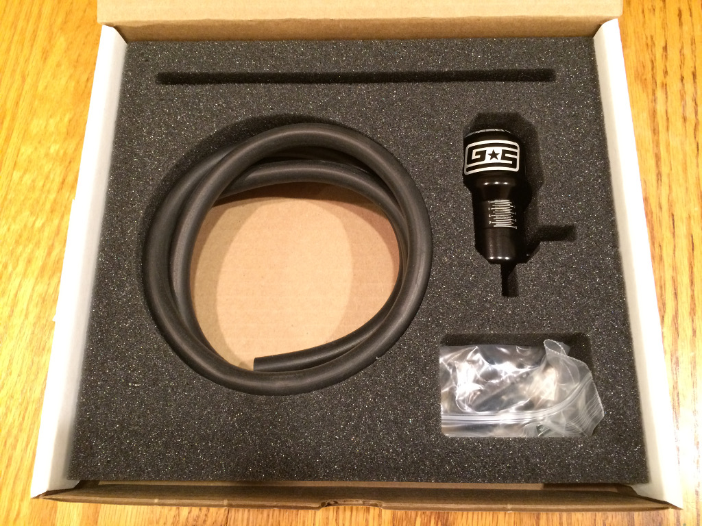

It comes with a mounting bracket, some hardware, zip ties, and more than enough hose to install it on my turbo setup.

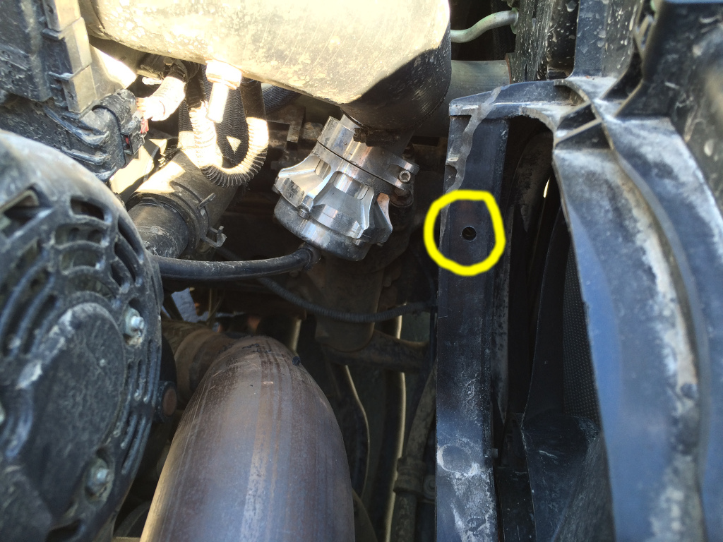

I chose to mount it here by drilling a 1/4" hole (ignore the trimmed plastic above the hole - that was originally done to provide clearance for the charge pipe silicone elbow when the kit was in the stage 1 configuration):
click for full size
http://www.uselesspickles.com/files/...illed_hole.jpg

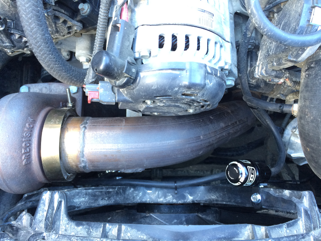

click for full size
http://www.uselesspickles.com/files/.../installed.jpg
The included mounting bolt was not long enough. I found a longer bolt at a hardware store, but used the included lock washer. I believe the bolt I bought was a M6x30mm (or maybe 35mm?) 1.00 thread flange bolt. I also used a M6 fender washer on the back side to spread the load of the nut across the plastic.
The boost controller is connected between the boost source and the wastegate. My boost source is on the silicone elbow that mounts to the throttle body, so this mounting location is perfect for minimizing the length of hose used. (NOTE: my wastegate boost source is different than Prodigy's official installation. Click for details)

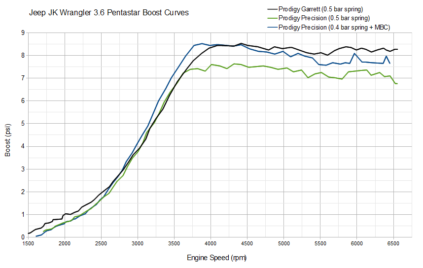

Aside from more power, this style of boost controller keeps the wastegate closed longer while spooling up to the target boost, compared to if you had a wasteagate spring alone that get to the same peak boost. That means less boost lag. At high RPMs where full boost is attainable, from a steady cruise to sudden full throttle, full boost is now reached in about 0.3s. Without the boost controller, the lag was about 0.5s. Just to be clear, this is not a complete delay in throttle response. You get full naturally aspirated power instantly, then it ramps up to full boosted power quickly/smoothly over the next 0.3s.
This decrease in lag also means that peak boost is available slightly lower in the RPM range. Here's a comparison of the boost curve from a 2nd gear full throttle acceleration. Included are the Garrett turbo with the stage 2 spring, Precision with the stage 2 spring, and Precision with the stage 1 spring + boost controller set for a max of 9.1 psi.
click for full size
http://www.uselesspickles.com/files/...oost_curve.png
NOTE: I started at lower RPM with the Garrett, so it had a chance to start spooling a bit lower in the RPM range. That may be why is has slightly more boost in the lower RPMs than the Precision.
I'm not sure why the Precision + MBC boost curve tapers off in the upper RPM range more than either of the curves without the MBC. The Precision without MBC seems to taper off a bit more than the Garrett, but it seems that adding the MBC caused it to taper off even more. It's possible that the data is just too "noisy" to draw any conclusions without getting an average of multiple runs. We will never find out for sure, because I'm not swapping turbos and wastegate springs again to gather additional data :)
