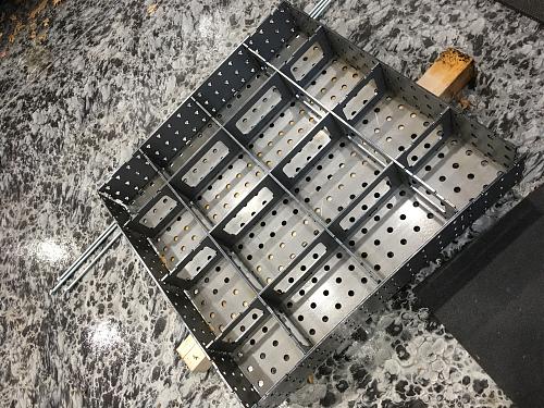

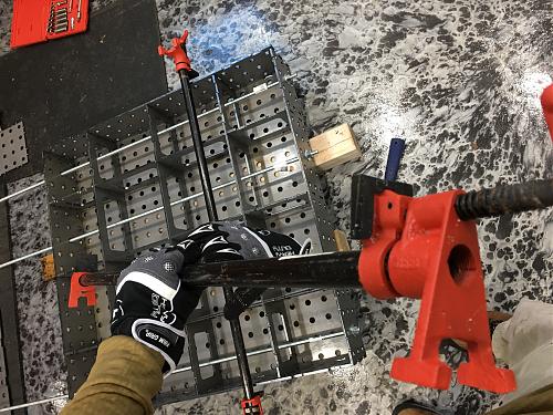

Laser cut pieces- its amazing how well it fits together once bolted and clamped. the steel pieces were not perfectly flat, I could see bends in them beforehand, that concerned me a little, but once the bolts were on, it was flat, with almost no attention.

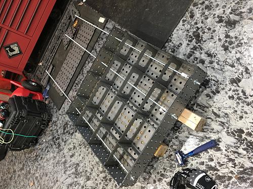

No intsructions- You have to rely on geek beats video which is REALLY GOOD, but, he is building a 30x30 table, with 3 sections so he needed 3 threaded rods. Mine is a 36x36, and there are 4 sections, I went to Home depot to buy the rods before the table was received, so I could jump right on it, but alas, I've just hit the wall on christmas day trying to build because my table has 4 sections instead of 3, So I need another threaded rod, that I cant get until tomorrow. Table specific instructions would have been nice.

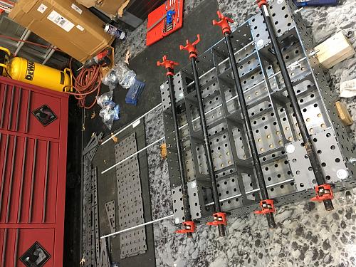

Here are some shots

And all the other pieces
Attachment 1747
