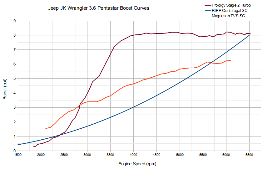

I got bored and took pixel-perfect measurements at every 100 rpm increment from Magnuson's own dyno chart to add their boost curve to my collection:
http://www.uselesspickles.com/files/...uson_boost.png
I don't know why that chart stops at 6100 rpm. looks like the torque curve is leveling out, so it probably doesn't go up any more, if at all, as it approaches 6500 rpm.
I'd like to add Sprintex to the chart, but I can't fund any charts with a boost curve. Has anyone seen anything?
This chart really belongs in a thread about comparing all major power modifications in general. Seems like it would be good to have a continuously updated post that lists all the options, gives basic info about each, provides links to more info about each, etc.

I took the boost data straight from Magnuson's own dyno chart (link in my post above was incorrect, but is now fixed). This is a chart that Ross posted on the wrangler forum, identifying it as a dyno chart from Magnuson:
http://www.wranglerforum.com/attachm...p;d=1390872766
If you know of any more recent data about that supersedes that chart, please point me to it so I can update my data.
