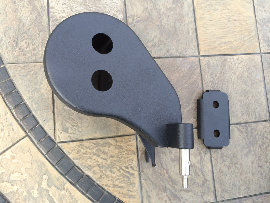

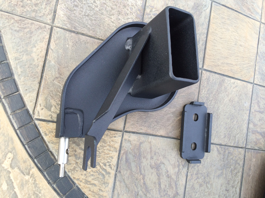

    First thing I noticed about the brackets is that they are bigger and sturdier than I expected. They appear to be made from a mix of 1/16", 3/32" and 1/8" thick steel. They are e-coated and powder coated, and the powder coating has a textured finish that almost exactly matches the textured plastic of the OEM mirrors (both in color and texture).

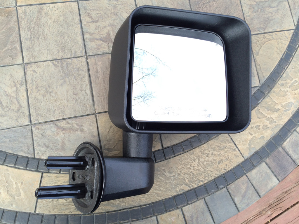

    I'm also impressed with the OEM knock-off/clone mirrors I got from EBay. I cannot see a difference between them and OEM mirrors. And they were only about $65 for the pair! They include foam padding for a nice vibration/noise-free fit, but they did not come with mounting hardware.

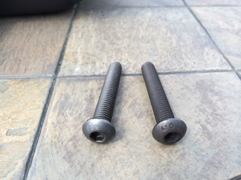

    If you were to just swap your stock mirrors over to the DieTech brackets, then you would re-use the original mounting bolts. Since I'm using a second set of mirrors, I went to the local hardware store and found bolts that would work (M8, 1.25 pitch, 50mm long).
    NOTE: I would NOT recommend using these to mount mirrors onto a door! The OEM bolts have a large flange to spread the load across the relatively thin sheet metal of the door. I'm not worried about the lack of flange on these bolts because I'm only using them on the DieTech brackets, and they are being tightened up against a 1/8" thick steel plate.

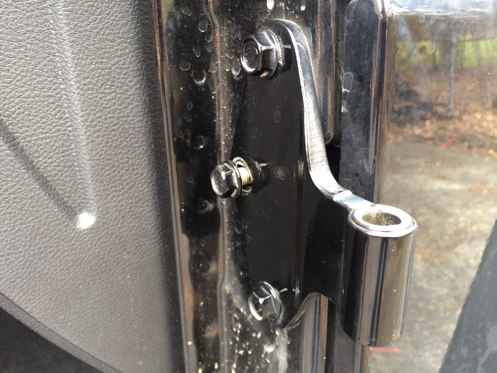

    Now that my spare mirrors are mounted on the brackets, they will stay together forever. With the doors off, first you need to loosen the middle bolt of the upper hinge. My only complaint here is that the bolt head is painted, so it inevitably chips/peels off on the corners the first time you tighten them back down with a socket. It's relatively unnoticeable, so I don't really care. Still better than a shiny non-painted steel bolt head.
    Slide the pin of the mirror bracket down into the top hinge, making sure the support arm slides down behind the loosened hinge bolt. Instructions recommend tapping the bracket down into the hinge with a rubber mallet if it doesn't slide in nicely. I got lucky and was able to push it down. Now re-install the stock hinge pin screw/cap (you know, that little thing that holds the door hinge pin in the hinge that many people never bother re-installing after removing doors for the first time), and tighten the hinge bolt against the support arm. That was easy.
