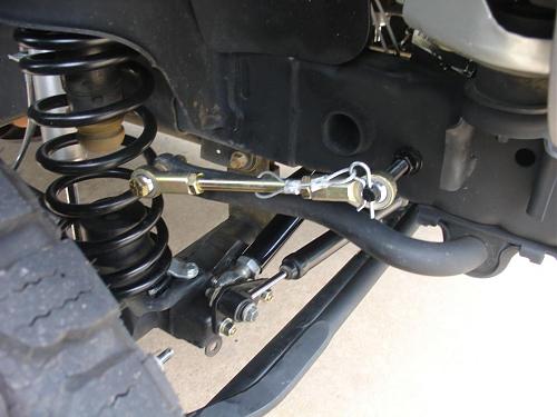

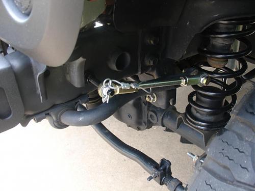

    I don't know what happened with the uploading of the photos but I think you get the picture. Hahaha, no pun intended!
    The material list includes:
    -1/2-13 All-Thread (different links may require a different size and cut to a different length)
    -1/2-13 Nuts (x4)
    -1/2" Washer (x2)
    -1/2" Lock Washer (x2)
    -1/2" Drill Bit
    -11/32" Drill Bit (Cotter Pin hole)
    -Paint (to prevent rust)
    Like I said, this was specific to my application, all sizes/ lengths may need to be adjusted for your particular application.
