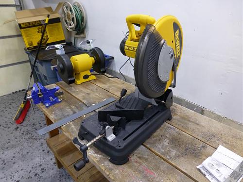

Here are the contenders -
Dewalt Multi Cutter D872
