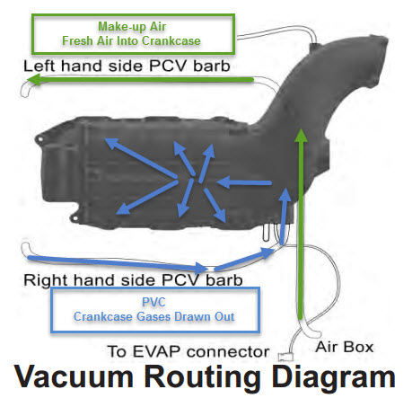

To start with I'm going to clean up the PCV system. Why, because recently I discovered that the vacuum from the s/c is strong enough to collapse the PVC hose from the install kit. At the same time the make-up air elbow that connects the make-up air line to the valve cover is easily kinked when installed per instructions. The kink can (and likely does) limit make-up air. When the PCV system doesn't function properly and/or flow freely the intake air-fuel charge becomes inconsistent which would make a tuner's job quite difficult.

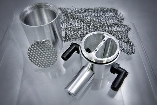

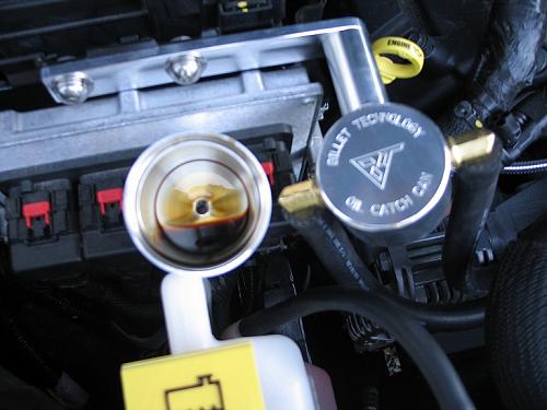

Just as important as making the system work right is enhancing it. I'm going to install a "catch can" which most of you are probably familiar with. The catch can is designed to remove oil from the vented crankcase gases so that the oil doesn't get routed through the $6k supercharger I bought. Oil in the PCV suction line will again, alter the air-fuel mix and make a tuner's job difficult. It will also settle on parts and gunk them up.
