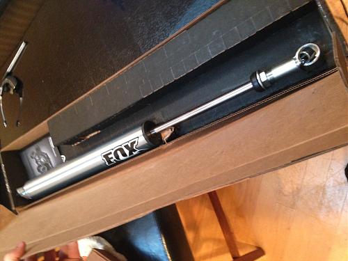

    You all know my steering has been acting up in a way that needs immediate attention.
    This is my first attempt to correct it. Its currently unsafe to drive my truck. She seems fine, but hit a bump while turning, and she freaks out, in a very scary way. Im planning to change all steering components, but I need to be able to drive her to a shop to do the rest of the work.
    Im going to change the steering stabilizer in the driveway and then work my way into the rest of the changes.
    I was opening the box for the stabilizer, figured you guys would want to see it.
    Here are the shots so far.
    Thanks to Chris from Synergy MFG for walking me through the trouble shooting process. Synergy ball joint thread coming soon.

    Yeah I'm ready for this one. I need to upgrade mine soon. Since I run Fox Shocks this is what I will probably go to.
    There is one level past this one where the shock has the shaft move all the way through it. It was out of my budget tho.
