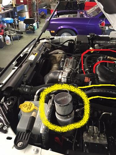

    Sorry if this was discussed before, but anyone already installed a catch can with the prodigy set-up? Do I still use the valve that is currently fitted?
    Also anyone getting oil in the small filter at the end of the make-up air hose the connects to the driver side manifold?

    I'm running a catch can, check one page earlier. I was getting oil from breather as well. I have a 2015 and I think the PCV system is a little different which may have been creating this issue. I think all new kits moving forward will use a catch can along with a vacuum line to intake perhaps.
    Mine works pretty well. I have seen a couple of drops by the mesh filter but no spraying oil for sure.
