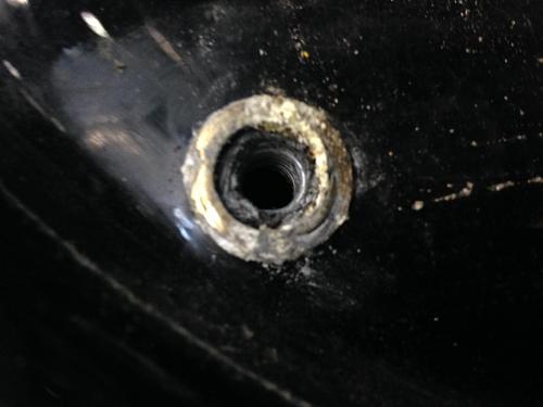

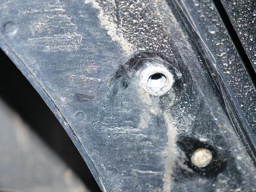

Otherwise, we stripped the flares off black betty, and found the nutserts in questionable condition.
Here's a pic.
I havent tried to clean them up yet, Im not sure if its corrosion, or salt, but im going to rub them with WD-40 and see.
I was going to take the truck to a car wash but realized that I do NOT want water getting in those holes.
Maybe Ill clean them up and then paint some POR15 on them.
I should mention that the nutserts are 6 months old.

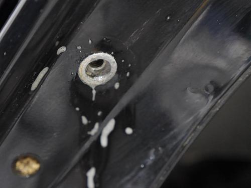

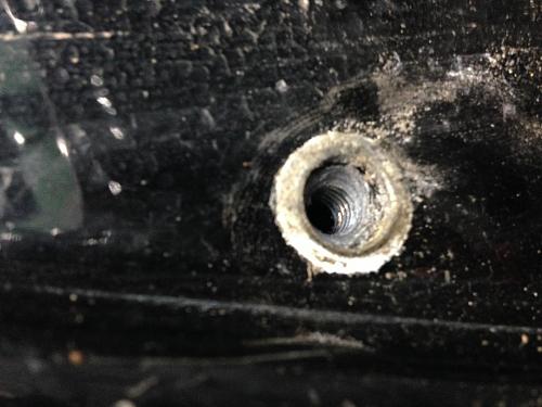

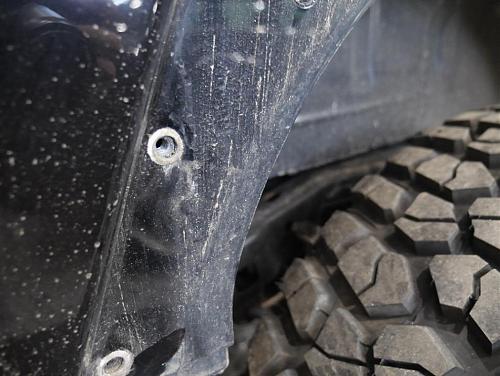

Here's some shots of the nutserts before I cleaned them.
The inside of the nutserts looks gross also, but I've decided that its the anti-seize that we put on the stainless steel bolts that hold the flares on.
The real concern here, is that if the corrosion eats through the outer ring of the nutsert, it will allow the nutsert to spin in the JK's super thin sheet metal. That would mean I'd be in a situation where the flare is half on and half off with the stainless bolt halfway out. Then I'd have to cut it off and drill out the nutsert.
Any way you slice it, you need to make sure to prevent that sort of problem rather than deal with it.

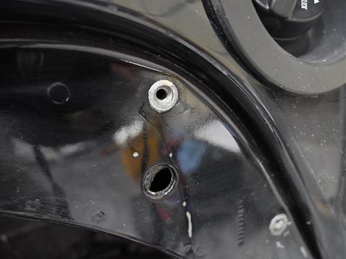

Here are the shots after I rubbed them with the simple green, on a towel first, then on a cotton ball that i jammed into each.
I should note I cleaned the section that I simple green'd with carwash spray.
I did not spray anything directly on the section. I didnt want to have any sort of moisture getting inside the body panel.

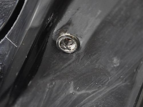

Here they are painted.
The technique is thin coats, but do a few of them. Also, cover up. gloves, long sleeves, if you get POR15 on you, its staying on you.
If you get it on your garage floor, its staying on your garage floor. They made it permanent on purpose.
The first coat, I could kind of see through. Then the second I got full coverage. I might do a third coat.
One other note, mix the POR 15 in the can, but then pour it into a paper cup. The brush will pick up contaminants when you brush it against rust and corrosion. You dont want to put that brush back in the can.
